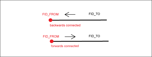

FID_FROM
Specifies a particular feature.
F_CLASS_ID_FROM Specifies a particular feature class.
FID_TO
Specifies the connected feature.
F_CLASS_ID_TO Specifies the connected feature class.
FLOW
Specifies the flow direction between a particular feature (FID_FROM) and the connected feature (FID_TO).
  • 1 = forward
  • 2= backward
  • 3= both
