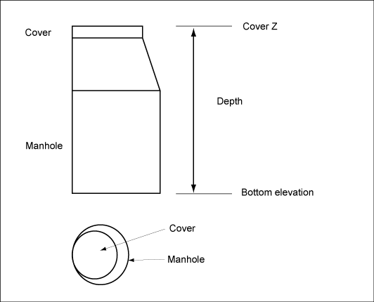

The cover height is stored in the attribute WW_COVER.Z, the terrain elevation of the manhole is stored in WW_POINT.Z. The soil elevation of the manhole is stored in BOTTOM_ELEVATION. The difference between soil elevation and terrain elevation is the depth.
