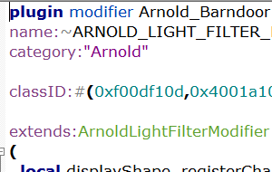

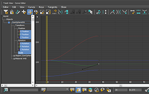

Scripted Plug-ins: Scripted Plug-ins now support new parameter types of #paramBlock2 and #point2. Scripted Plug-ins now support new parameter event handlers preSet and postSet that are guaranteed to use the original and new parameter value respectively. Scripted MAXtoA plug-ins can now be created for Arnold nodes. | TrackView:There are new filter flags for TrackView: #activeLayer and #unlockedTracks. There is a new method to test flags, testFilter() .The Mixin Interface trackviews.current.ui now exposes the getToolbarObjectName method to retrieve the non-localized toolbar name. By contrast, the getToolbarName method returns a localized string. |

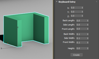

Geometry Objects Type-in Properties:The Keyboard Entry properties for several geometry objects are now exposed. These properties are now available for Box, C_Ext, ChamferBox, ChamferCyl, Cone, Cylinder, L_Ext, Prism, Pyramid, Sphere, Teapot, Torus, and Tube.The C_Ext and L_Ext now also define the .CenterCreate property which controls the offset of the mesh as though it had been created from its center. |

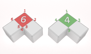

Chamfer Quad Intersection Mode: The following boolean properties have been added to control the quad intersection mode. Enabling this mode attempts to preserve the quad structure of the faces participating in the chamfered edges. Chamfer.quadIntersectionMode Edit_Poly.edgeChamferQuadIntersections Editable_Poly.edgeChamferQuadIntersections |
