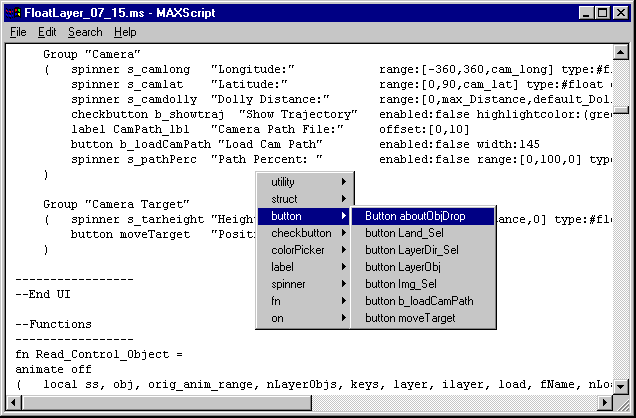

CTRL+Right-Click
Displays a pop-up menu of all the utility, structure, user-interface item, function, handler, plug-in, tool, Macro Script, and rcmenu definitions that exist in the current script. Select one of the items in the pop-up menu to position that definition at the top of the Scripting Editor window. This simplifies large script navigation.
