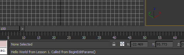

UtilObj::BeginEditParams()
is called when the utility plug-in is started and usually adds the UI panel we have defined in the .rc file to the 3ds Max window as a rollout panel. When 3ds Max calls this function, it includes a pointer to the 3ds Max main interface as an argument that we will use to access the Interface::PushPrompt()
function that prints a message in to the prompt area:
void UtilitySample::BeginEditParams(Interface* ip,IUtil* iu)
// This is template code:
this->iu = iu;
widget = new QWidget;
ui.setupUi(widget);
// We can connect UI signals here using Qt Functor syntax
QObject::connect(ui.pushButton, &QPushButton::clicked, this, &UtilitySample::DoSomething);
ip->AddRollupPage(*widget, L"Plug-in Rollup");
// We add this for Lesson 1:
ip->PushPrompt(_M("Hello World from Lesson 1. Called from BeginEditParams()"));
Adding the last line has resulted the following message to appear in the 3ds Max window when the UtilitySample plug-in is selected from the utility plug-in list:
However, this message will stay in the prompt area even if another plug-in is selected. We will need to pop this message from the prompt stack when the plug-in is not active anymore. We edit the function UtilObj::EndEditParam()
for this purpose. This function is called by 3ds Max when the plug-in is de-activating. This function is implemented as following in the included project Lesson1a:
void UtilitySample::EndEditParams(Interface* ip,IUtil*)
this->iu = nullptr;
ip->DeleteRollupPage(*widget);
ip->PopPrompt();
Adding the last line will remove the last message in the prompt area and restore it to its previous message.
