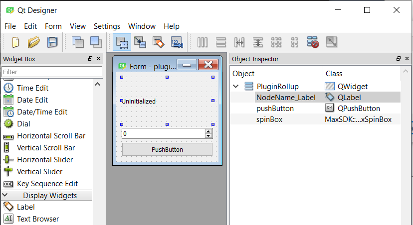

Before starting to edit the source code, we need to make sure that we have a placeholder for the name of the selected node in the plug-in UI panel.
If you are using the plug-in wizard, add a static text widget (QLabel) to your dialog within the .ui file to show the name of the selected scene object. To do this, right-click and select Open for the plugin_form.ui in Visual Studio. This will open the form in Qt Designer. Drag in a new Label widget, set its text to "Uninitialized" and re-name it "NodeName_Label". You can delete the two place-holder labels ("Generated by Autodesk 3ds Max" and "TODO: Place panel") created by the plug-in wizard.
