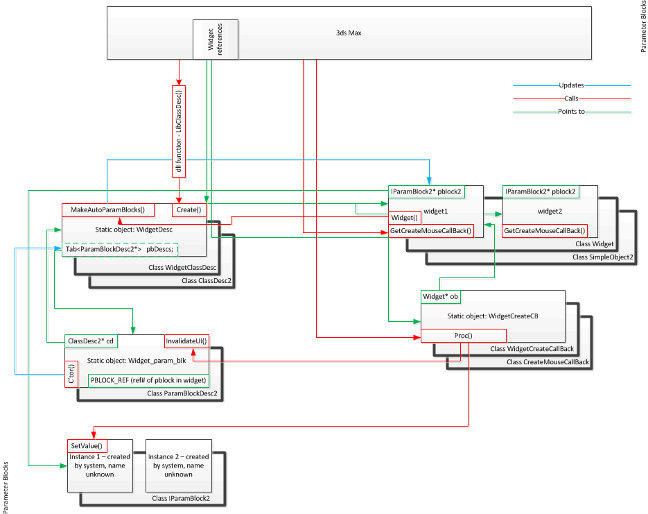

The number of parameter blocks per plug-in, as well as the number of parameters within a parameter block is not limited. The parameter blocks in a plug-in are identified by their ID, which is usually zero for the first parameter block and increments for the next ones.
Developers do not directly call the parameter block's constructor to create the parameter blocks for their plug-in. Instead, they instantiate a static parameter block descriptor (a static object of type ParamBlockDesc2) by passing the appropriate arguments to its constructor for each parameter block. These arguments describe the parameters that you want to include in that parameter block. The constructor of ParamBlockDesc2 automatically creates the described parameter block (an object of type IParamBlock2) and registers the address of the newly-created parameter block in a table in the plug-in's class descriptor. The following figure demonstrates this procedure for a geometric object plug-in named Widget. The Widget plug-in project exists in the "how to" folder of the 3ds Max SDK at <3ds Max Installation folder>\maxsdk\howto\objects\widget.
The parameters in a parameter block are accessed using their index number or parameter ID's. For each of its parameters, the parameter block stores at least the parameter value, the parameter ID, an internal name (used by MAXScript), and the parameter type. There can also be additional data for a parameter, such as the default value, the range of the parameter, the UI type, and others. Developers must use the tags defined in the ParamTags enumeration in the call to the parameter block constructor if they want to include these additional data for a parameter. Declaring a parameter in a parameter block is primarily done in the constructor call of the parameter block descriptor, but it can also be done later on by calling the function ParamBlockDesc2::AddParam() as long as there have been no parameter blocks created using that descriptor object.
Parameters within a parameter block can be reference types (references to ReferenceTarget objects), scalar types such as TYPE_FLOAT, aggregated types such as Point3 or Matrix3, external assets to the scenes such as file names and so on. Refer to the documentation for ParamType2 for a complete list of valid parameter types. If a parameter is a Controllers, a default animation controller is automatically assigned to it and the developer can change it later. If animated, you have to provide a value-time pair when you want to write to the parameters (using IParamBlock::SetValue()) and provide a valid time when you want to read from them (using IParamBlock::GetValue()). You can access a non-animated parameter using the current time. The next section describes in detail how a parameter block can be created and accessed.

The above code calls the constructor of ParamBlockDesc2 to create the static object myPBDesc. The address of the static ClassDesc2 object in your plug-in that is provided in the list of parameters (&myPluginDesc) is used to register this parameter block descriptor in the static ClassDesc2 object . By the time the static ClassDesc2 object calls its ClassDesc2::Create() function, it has the address of all of its parameter blocks and also knows to which reference in the plug-in each parameter block must be assigned. However, this is not done automatically. It is the responsibility of the plug-in developer to assign the addresses of the parameter blocks (registered in the static ClassDesc2 object) to its IParamBlock2 pointers as references. This can be done in the constructor of your plug-in as shown below:
MyPlugin::MyPlugin()
    myPluginDesc.MakeAutoParamBlocks(this);
The function ClassDesc2::MakeAutoParamBlock() uses the address of the parameter blocks as well as the reference index in the plug-in to set them as the reference targets in the plug-in (remember that the class IParamBlock2 is extended from the class ReferenceTarget).
