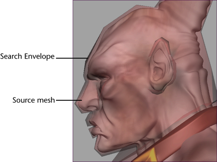

- Search Envelope (%)
The search envelope is a user-editable piece of geometry that defines the search volume or threshold of the transfer map generation operation.
This attribute sets the size (%) of the target meshes’ search envelope. If you set the Search Envelope to 10, then the size of the envelope will be 10% larger than its target mesh.
You can edit the search envelope’s vertices to fine tune its shape and coverage.

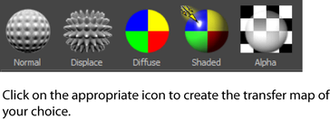

Output maps
Select a map type from the list of icons available. The section for the selected map type appears. You can create as many maps as you need.

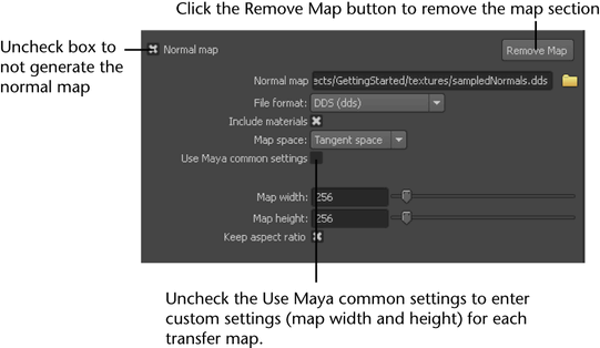

- Uncheck the box beside the map type (for example, Normal map) to remove it from the list of maps to generate;
- Click the Remove Map button to remove a map from the list of maps;
- Check the Use Maya common settings options to honour them;
- Uncheck the Use Maya common settings options to enter custom settings for each transfer map.
Your settings (for example, the map sections that you have created and checked) are saved with each session of Maya.

- Use Maya common settings
If you plan to create several maps with the same width and height, you can reuse your settings by entering them in the Maya Common Output section of the Transfer Maps window.
If you uncheck this option, the Map width and Map height attributes appear within the Normal Map section of the window. For more information regarding these attributes, see Maya Common Output .

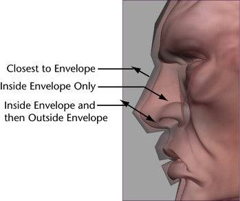

Search Method
Sets where in relation to the search envelope the target meshes are being looked for.
- Closest to Envelope
Search for target meshes outside the envelope.
- Inside Envelope then Outside Envelope
Search inside and outside the envelope for target meshes.
- Inside Envelope Only
Search only inside the boundary of the envelope for target meshes.
