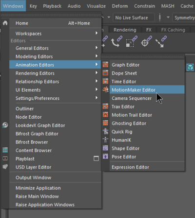

Launching the MotionMaker Editor
Navigate to Windows > Animation Editors > MotionMaker Editor.

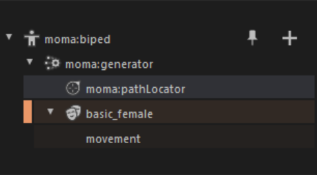

Outliner: Displays imported proxy characters and their associated nodes.

Select moma:biped and moma:pathLocator in the Outliner .
Move the selected items to the right of the viewport.

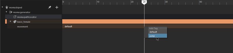

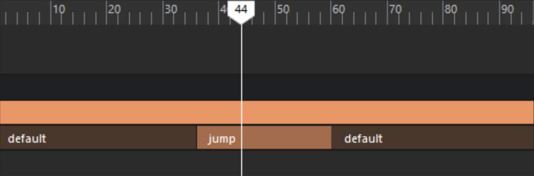

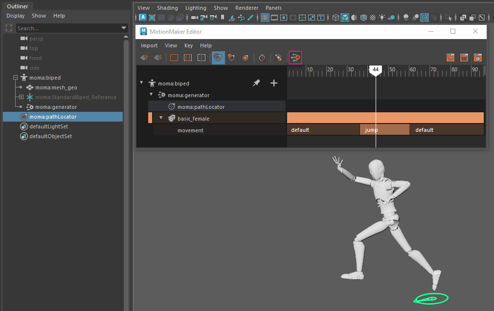

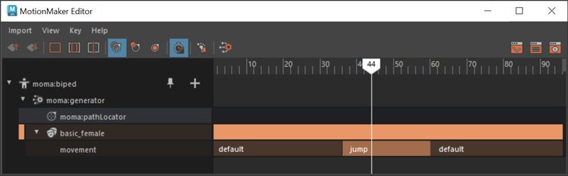

Add an action tag:
Set Jump action.
Go to frame 24.
Right-click on the character's movement bar and select jump from the dropdown list.
Set action to default.
- Go to frame 48.
- Right-click on the character's movement bar and select default from the dropdown list.
- With moma:pathLocator selected, click Generate Motion.
- Preview the animation by playing it back or scrubbing through the timeline.

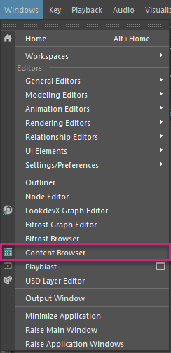

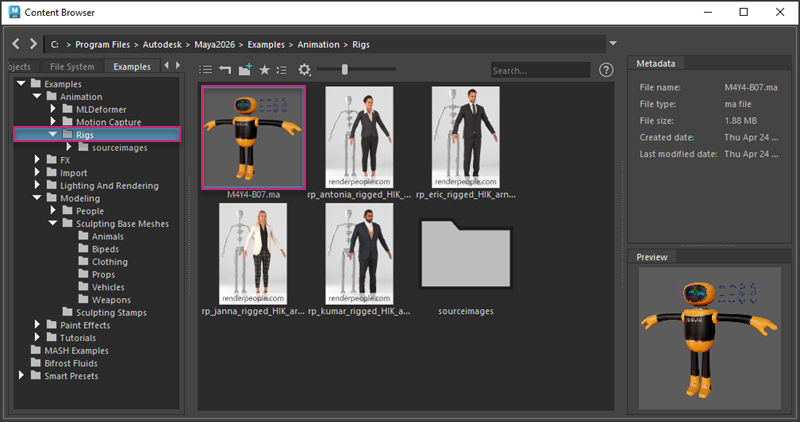

Open the Content Browser.
Navigate to Windows > Content Browser.
Import the M4Y4-B07 character.
In the Content Browser, navigate to Examples > Animation > Rigs.
Left-click and drag the M4Y4_B07.ma character into the scene.

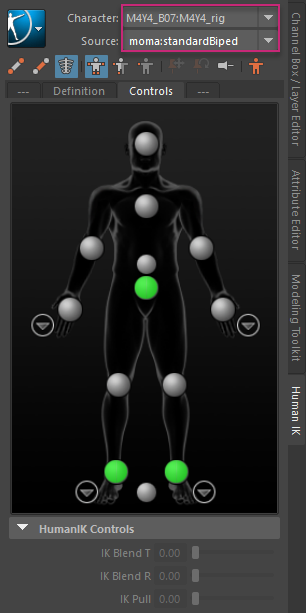

Open the Human IK Panel by clicking the button in the top right-hand corner of the Maya UI.
Configure the character for retargeting:
Select M4Y4-B07:M4Y4_rig as Character.
Choose moma:standardBiped as Source.
Note: The M4Y4-B07 character will automatically snap to its new position.
