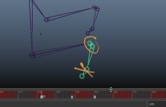

Time Slider Bookmarks
Time Slider Bookmarks are colored tags along the top of the Time Slider that flag events in your scene. Bookmarks let you draw attention to specific moments in time, which is useful when you want to focus or highlight specific areas or moments in your scene.

Color Coded Keys
Colors indicate on which curve the key is set
Turn on this option to show key ticks with colored "beads" to indicate which animation curve affected by the key.
A Time Slider color coded key tick showing what each color indicates
Set custom colors for Translation, Rotation, Scaling, and Other keyed attributes in the Color Settings.
