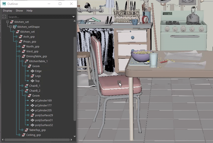

When working with a USD set in Maya, clicking in the Viewport selects an exact prim. This often results in the partial selection of a model. If you want to manipulate an entire model or set, you need to manually select it in the Outliner. You can override this behavior with the optionVar UsdSelectionKind and UsdPointInstancesPickMode. Choose a selection mode to reflect changes when you select prims in the Viewport and Outliner. Note: Default fallback selection mode is by prim.

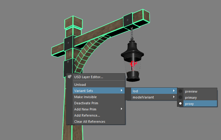

Right-Click Context Menu
When you right-click a USD object in the Viewport, a contextual marking menu appears to help you select the exact object(s) you want to modify.

  1. Selection by Kind has the following modes:
    • optionVar -sv "UsdSelectionKind" "model" ; Selects the nearest ancestor that is a model or its subcategory.
    • optionVar -sv "UsdSelectionKind" "group" ; Selects the nearest ancestor that is a group or its subcategory.
    • optionVar -sv "UsdSelectionKind" "user-defined" ; Selects the nearest ancestor that is a user-defined kind or its subcategory.
    • optionVar -sv "UsdSelectionKind" "" ; Selects the exact prim that is picked in the viewport. This returns Viewport selection to its default behavior.
In the following example, we override the default Viewport selection behavior to select entire models in the USD set:
