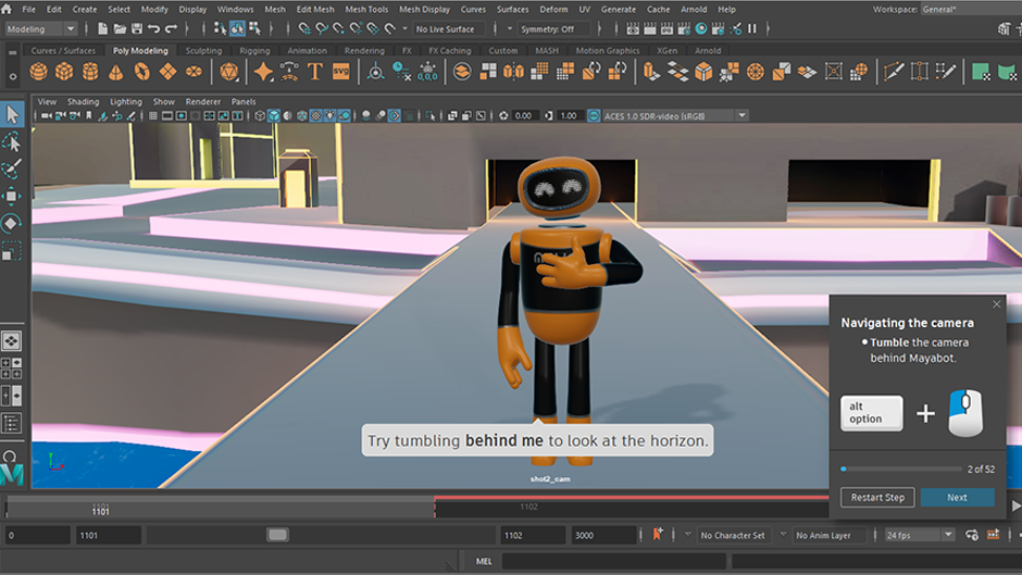

There are three pre-made types of 2D overlays:
| Overlay Type | Hello World example | Result |
Progress Dialog: A two button dialog window designed as a tutorial controller. |
import moverlay as mo
from PySide6.QtCore import QPoint
def pressNext():
print("Next was pressed")
def pressReset():
print("Reset was pressed")
def pressClosed(dialog):
manager.controller.deleteLater()
#create manager object and assign its controller
manager = mo.maya.overlayManager()
manager.controller = mo.progressDialog.ProgressDialog(manager.getMainWindow())
#Assign title and body text
manager.controller.setTitle("Example Dialog")
manager.controller.setBodyText("Hello World")
#Create buttons and attach them to appropriate procedures when clicked
manager.controller.setupButton(0, "Reset", pressReset)
manager.controller.setupButton(1, "Next", pressNext)
manager.controller.setCloseCallback(pressClosed)
#Create a progress bar with 10 steps
manager.controller.progressBar().resetSteps(1, 10)
#Re-size and position the controller
manager.controller.theDialog().resize(mo.utils.DPIScale(180), mo.utils.DPIScale(250))
manager.controller.theDialog().moveToScreenPos(QPoint(0, 0))
#Display the controller
manager.controller.showAndRaise()

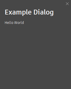

HIG Dialog: A no button dialog window designed for displaying hints or diagrams |
dialog.deleteLater()
#Create manager and dialog object
dialog = mo.higDialog.HIGDialog(manager.getMainWindow())
#Assign body text
label = dialog.setAsLabel('<h1>Example Dialog</h1><p>Hello World</p>')
#Assign close procedure
dialog.setCloseCallback(pressClosed)
#Re-size and position the dialog
dialog.theDialog().resize(mo.utils.DPIScale(180), mo.utils.DPIScale(250))
dialog.theDialog().moveToScreenPos(QPoint(0, 0))
dialog.theDialog().setFixedWidth(250)
dialog.showAndRaise()

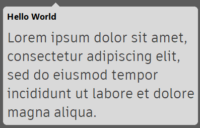

Bubble: A non-interactable word bubble that appears in a designated position. Note: To remove overlays, you can call overlayManager's deleteAll() procedure.
from PySide6.QtCore import QSize
from PySide6.QtGui import QColor
#Create manager and overlay definition
od = mo.overlayDef.OverlayDef(QSize(300, 100))
#Position relative to screen center and apply the style and color
od.style = mo.enums.OverlayStyle.SpeechBubble
od.attachment = mo.enums.RelTo.Center
od.bgColor = QColor(217, 217, 217, 255)
#Create this overlay
overlay = manager.createOverlay(od)
#Assign body text
label=overlay.setAsLabel("""<h2>Hello World</h2><p style="color: #3C3C3C; font-size: 16pt; font-weight: normal;
font-style: normal; font-family: Artifakt Element">Lorem ipsum dolor sit amet, consectetur adipiscing elit,
sed do eiusmod tempor incididunt ut labore et dolore magna aliqua.</p>""")
#Add a word bubble tail
overlay.addSpeechBubbleTail(mo.enums.Direction.Top, 0.25)
#Display the overlay bubble
manager.showAll()
