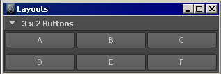

Layouts are UI elements that contain and arrange other UI elements. They are the principle means of controlling formatting in ELF windows. There are a number of different specialized layouts that arrange their contents in particular ways. For example a column layout arranges its contents vertically one after another in a single column, like a list, whereas a row layout arranges its contents horizontally beside each other. There are other layouts for other arrangement schemes. Layouts can contain other layouts to achieve a wide variety of appearances. All commands that create layouts end in Layout; for example, gridLayout.

Frame layout
A frame layout has an expand/collapse option in which it has a button beside its title to toggle its state. When in the collapsed state the contents of the frame layout are hidden and the layout collapses to take up very little space. The frameLayout callbacks for expanding or collapsing layout are only called if the layout is collapsed or uncollapsed through the visible interface (for example, the small arrow icon the user can click.) Using code such as the following will not invoke the callback:
frameLayout -e -collapse true $theFrame;
Having callbacks work in this way is the only way we can allow things to get set up correctly when the window is first being created without getting into infinite loops. If a callback is needed and you know it is safe then call it directly at the same time you do the collapse or expand.
