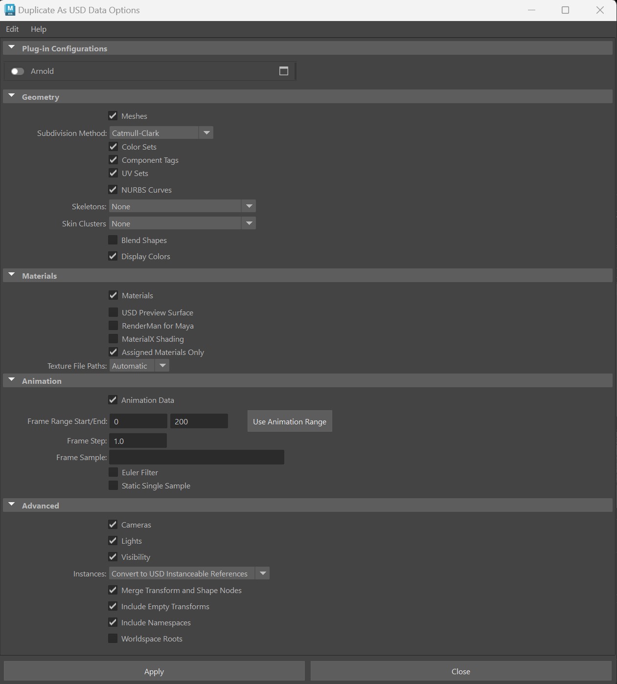

- Select Options... to choose the way your Maya objects are exported to USD. The Duplicate as USD Data window appears with the same options as the typical export options; including Geometry, Materials, Animation and Advanced settings. In this window you can set your preferences for the export. After building out the scope of your options, select Apply to apply your settings or Close to cancel the operation. Important: When you duplicate edits to USD, the options in this dialog that you select can persist in Maya memory from the last time you exported and even in your last Maya session. Ensure you check these settings each time as your selections can be saved in Maya. You can also select Edit from the top left menu in this dialog to Save Settings or Reset Settings for any Maya data export processes.
