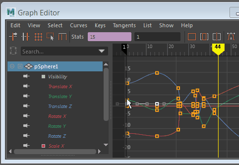

The Graph Editor Outliner Search field lets you filter objects in the Graph Editor, which is useful for tracking down nodes in large scenes. With the object selected in your scene, start typing in the Search Field and any associated objects will highlight.
Channels in the Graph Editor outliner
If an object is animated by simple keyframe animation, for each attribute of the object you select, there will be one animation curve driving that attribute. In this case, each of the animated attributes (channels) of that object will be listed indented below the object.
