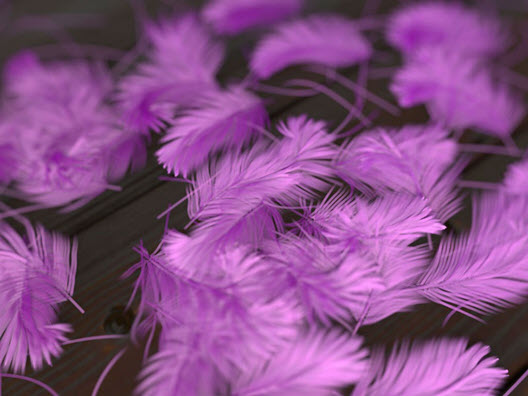

Feather rendered as curves
This tutorial will cover how to render a feather using a paint effects brush that has been converted to curves.

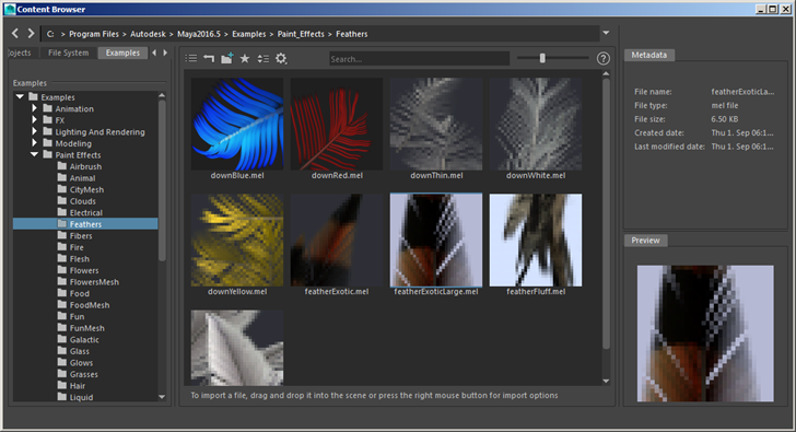

- The curves were first generated as a Paint Effects brush - strokeFeatherExoticLarge.mel and then converted to curves - Modify>Convert>Paint Effects to curves.

That concludes this tutorial on rendering curves as feathers. Rendering curves as hairs using override sets is a useful way to create complex looking scenes without the overhead of working with heavy amounts of geometry.
