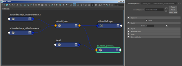

  • Create another Include Graph operator and Rename it to lookdev_1.
  • Create a switch operator. This will be used to switch between graphs that we want to use for rendering.
  • Connect all of the Include Graph operators to the Switch operators Inputs.
Look dev Include Graph operators -> Switch operator

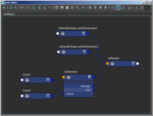

  • Merge the Collections together using a Merge operator and rename it Collections.
Merge Set Parameters
  • Now we need to merge our material assignment ( Set Parameter operators) using another Merge operator.
  • Reconnect the Set Parameter operators to this Merge operator.
Collections -> Merge operator

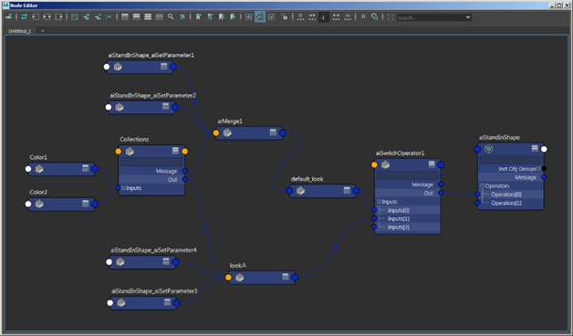

We can now create multiple looks by duplicating our existing Set Parameter operators that we can re-use (also for different characters).
  • Duplicate Set Parameter 1 & 2 and the Merge operator.
  • Change the Assignment of Set Parameter 3 to use the 'blue' shader.
  • Change the Assignment of Set Parameter 4 to use the 'red' shader.
The final operator graph should look something like this:
  • Select the Target node and export the look.
  • Render the scene. You should now see that the blue and red shaders are now being rendered instead.
You can now change the Switch input numbers to alternate between the default_look and look1. Repeat the above procedure for more look devs, but choose different colored shaders (ie yellow and green).
