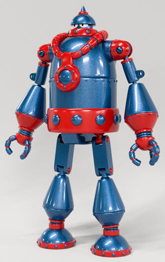

'Default' look | Look A | Look B | Look C |
Multiple shaders applied using operators
Operators can be useful for applying different looks by assigning shaders at render time. This can give you extra control at the end of the pipeline stage. It can be a powerful tool, especially useful when rendering Alembic files and Procedurals/Stand-Ins , where you may need to assign shaders to separate pieces of geometry.
In this tutorial, we will cover how to look dev a robot character. This will involve e xporting materials and looks as:

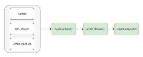

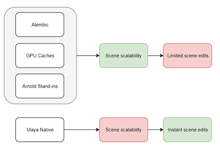

Alembic files, GPU Caches, and Arnold Stand-ins have limited flexibility in what you can achieve with render time shading effects
Operators can give you far more flexibility with assigning shaders at render time
