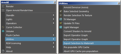

  • First, select the robot geometry (whose shaders you wish to export) and go to Arnold > Utilities > Export Selection to MaterialX.

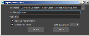

  • Choose where you want to save the .mtlx file and give it a Look name.
  • Assign different shaders to the robot model (ie red & blue, green & yellow and black & gold) and repeat the above process, but choose Look B and Look C for the Look Name. Choose to save to the same .mtlx file (the Looks will be appended to the file).

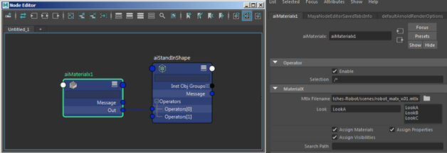

Import MaterialX File
  • Create a Procedural Stand-in and open the robot.abc file.
  • Create a MaterialX operator and connect it to the Input of the Stand-in.
  • Open the .mtlx file that we exported earlier in the MaterialX operator. You should see the A, B and C Looks that we saved to it.
  • Lastly, add /* to the Selection. This will add the Look to the robot selection.
  • Render the scene. You should be able to choose which Look you want from the MaterialX Look and it will update in the render view!
