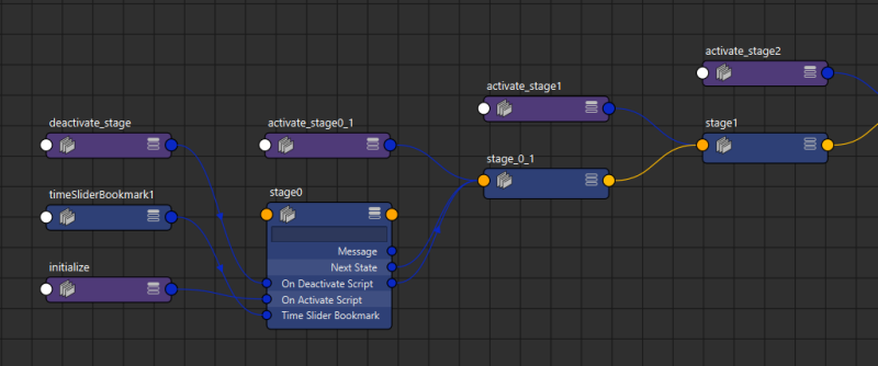

To view the state machine
  1. In the Outliner, turn off Display > DAG objects only.
  2. Filter by the term "stage".
  3. Select all the stage nodes.
    Note: There will also be a number of "activate_stage" nodes alongside the stage nodes. You do not need to worry about these yet.
  4. Open Windows > Node Editor.
  5. Click the Show Inputs / Outputs button () to display the stage nodes and their connections.
At this point, you can see how the tutorial stage nodes are structured. Some important things to pay attention to include:
  • On Activate Script: This is the script node where the bulk of each stage happens. You can view the Python code in the Expression Editor (see below).
  • On Deactivate Script: Connect a script node here to clean up after a stage once it's finished. It's good practice to try and keep your stage logic self-contained so that it's easy to move them around or insert/delete them as needed. In the example above, it's clear that a stage0_1 was inserted between stage0 and stage1 at some point during development. It can also be handy to design a universal deactivate script that can be used by all stage nodes, allowing you to simply connect all the On Deactivate Script attributes down the chain for readability.
  • Time Slider Bookmark: This is handy for setting up animations at the beginning of a stage, but also for changing the state of a scene between one stage to another. For example, you can keyframe the active camera at the start of the bookmark to have the camera jump to a different spot in the scene at the beginning of the stage. Or you can keyframe an object's visibility to have it appear during one stage but not another.
