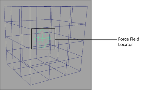

The Force Field locator appears inside the mesh of the selected object, and the dynamicConstraint node appears in the Attribute Editor.

- Adjust the location, size and rotation of the Force Field constraint using Maya’s Move, Scale, and Rotate tools.
The location, size and rotation of the locator determines the size, shape and volume of the force field constraint.
