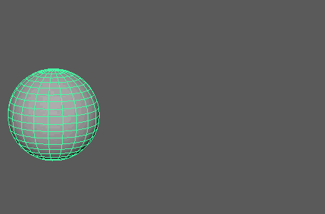

Causes points on a mesh to shake as they move. However, unlike a regular Jiggle Deformer, this jiggle can interact with MASH falloff objects, maps, etc. It does not require a MASH network to use.
