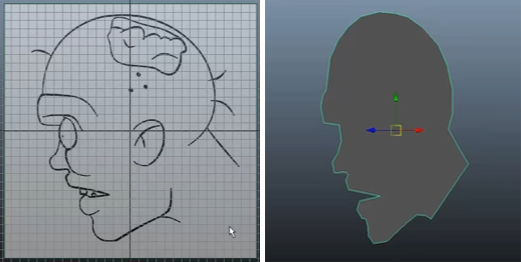

Instead of starting with a basic primitive shape, you can also start your polygon mesh by drawing it using vertices. This is useful if you have a specific 2D shape that you want to trace.

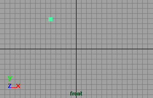

- Click to place the first vertex.
Maya places vertices on the ground plane unless you snap them to existing geometry.

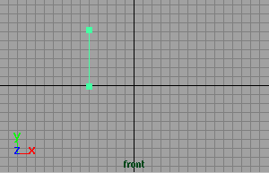

- Click to place the next vertex. Maya creates an edge between the first point and the last point you placed.

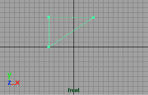

- Place another vertex. A dashed edge connects the three vertices.

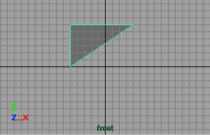

Important: The way you place vertices determines the direction of the face normal. If you place vertices in a clockwise direction, the face normal points downward. If you place vertices in a counter-clockwise direction, the face normal points upward.
- Do any of the following:
- Press Enter to finish the polygon.
