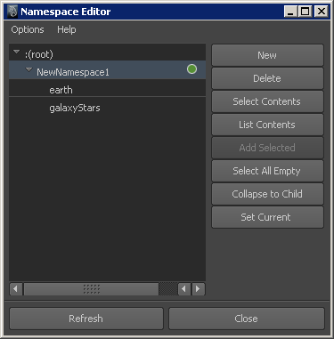

Create namespaces using the Namespace Editor
To create a namespace using the Namespace Editor
- Open the
Namespace Editor by selecting
Window > General Editors > Namespace Editor.
The Namespace Editor appears.
- Click
New.
Maya creates a new namespace.
- To rename the new namespace, double-click it.
The Rename Namespace window appears.
- In the Rename Namespace window type a new name, and then click OK.

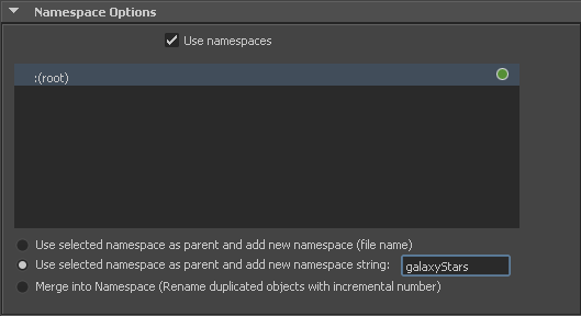

Create namespaces when referencing or importing
When you are creating a file reference or importing a file, you can create the namespace used by the referenced and imported objects.
To create a namespace during file referencing or importing
- In the parent file, select
File > Create Reference
The Reference Options window appears.
- In the Namespace Options, turn on Use namespaces.
- Specify how the namespaces are generated by selecting one of the following:
- Use selected namespace as parent and add new namespace (file name) to prefix the namespace with the filename.
- Use selected namespace as parent and add new namespace string to prefix the namespace with a text string. Type your string in the field provided.
- Merge into selected namespace and rename incoming objects that match to merge the object's namespace with an existing namespace.
In the case where duplicate namespaces occur, the namespaces are merged and duplicate object names are incrementally suffixed with a number. Use this option to avoid an accumulation of new namespaces each time your referenced or imported objects have the same namespace.
- If you want to specify a unique name or text string rather than the filename for the namespace, select
New Namespace String , and then type your string in the field that appears.
- Click
Reference.
A File Browser appears.
- Navigate to the file you want to reference and then click
Reference.
The file is referenced into the parent scene. If you open the Outliner, you can see that the object names for the referenced objects are all prefixed with either the referenced file's name or your namespace text string.
