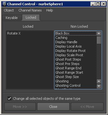

To lock a channel in the Channel Control menu
- Select .
The Channel Control Editor appears.
- Click the Locked tab to reveal the Locked and Non Locked lists.
- Select the channel and click
to change its status to Locked.
The process of managing attributes in the Locked tab of the Channel Control window is the same as that used in the Keyable tab.

To unlock a channel in the Channel Control menu
- Select .
to change its status to Non Locked.
