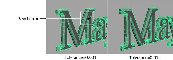

Where curve changes direction, the bevel is not correct
The Attribute Editor’s illustratorforBevel tab includes a Tolerance attribute that can help fixing beveling problems. In an imported Adobe Illustrator file, if a curve is next to a line, the line point may be in a slightly different position than its neighbors. This can cause bevel errors where the bevel extends into space away from the main curve.
Possible solutions include:
- Increase the value of the Tolerance attribute after import
- Fixing the curves in Adobe Illustrator and re-exporting. This may be necessary if changing the value of the Tolerance attribute makes the points snap in a way you don’t want. Note:
If you use Tolerance, CVs may be snapped together. This can cause edges with zero length, which can be removed with the Poly Cleanup Tool.
