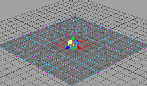

Soft Selection lets you select vertices, edges, faces, UVs, or even multiple meshes in an organic way. It's useful for making smooth slopes or contours on your model without having to transform each vertex manually. Alternatively, you could also use Sculpting to accomplish the same effect.
It works by maintaining a falloff from the selected components to the components around your selection to create smooth transitions. For example, if you select a vertex at the center of a plane and translate it up into a spike without Soft Selection, the sides are very steep and the point is very sharp. When Soft Selection is on, the slope and tip are smoother.

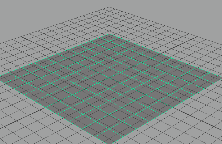

- In your scene, move your cursor over the mesh to preview the falloff area.
The falloff area is represented by a color gradient. The gradient is applied to all of the components that are within the falloff area.
- Resize the falloff area in one of two ways:
- b + middle-drag left or right to increase or decrease the size of the falloff area starting from 0.
- b + drag left or right to resize the falloff area starting from the last radius value.
B-drag to resize the selection area
- Select a component.
All components within the falloff area are selected and the selected transform tool manipulator appears.
- Use the manipulator to transform the components located within the falloff area.
