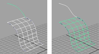

Make a curve tangent or curvature continuous with a surface
- Select the surface and then the curve.
- Select .
- Set Construction to Tangent or Curvature.
- Click
Project.
Select the project tangent node and click the Show Manipulator tool to manipulate curvature scale, tangent scale, or tangent rotation.

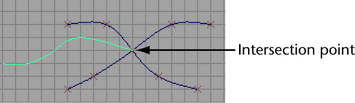

To make a curve tangent or curvature continuous with a curve intersection
- Choose .
- Click the curve or surface edge you want to modify, near the end which intersects the surface.
- Click two intersecting curves that define a plane.
To make a curve tangent or curvature continuous with another curve
- Make sure the endpoint of the curve you want to make tangent intersects the curves that define the plane.
- Select the curve you want to reshape first, then select the other curves.
The projected tangent is based on the key curve (the curve you select last, highlighted in green).
- Select .
- Click
Project.
