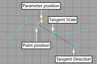

To reshape a curve with the Curve Editing tool
- Select Curves > Edit Curve Tool.
- Click the curve.
- Do any of the following:
- Drag the parameter position handle to move the manipulator along the curve.
- Drag the point position handle to move this point. The curve will reshape so the curve passes through the point as you move it.
- Drag the tangent direction handle to change the direction of the curve at this point.
- Drag the tangent scale handle to change the “speed” of the curve at this point.
- Click a dashed line to align the tangent at this point with one of the axes.

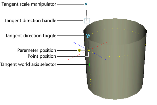

To reshape a surface with the Surface Editing tool
- Select .
- Click the surface.
- Drag the parameter position handle to move the manipulator across the surface.
- Drag the point position handle to move this point. The surface will reshape so the surface touches the point as you move it.
- Click the tangent direction toggle (the double circle) to switch between editing the U, V, and Normal tangent.
- Drag the tangent direction handle (the box) to change the tangent of the surface at this point.
- Drag the tangent scale handle to change the “speed” of the tangent at this point.
Tip: The Surface Editing Tool deforms a region within two spans of the manipulator. Deformation decreases with distance from the tool position.
You can use the Snap to curves option in the Status Line to snap the manipulator to an isoparm, or Snap to grids to snap to a patch corner. The snapping occurs to the isoparms or patch corners that appear when you display the object with —not the isoparms or patch corners that appear only with finer Smoothness settings.
