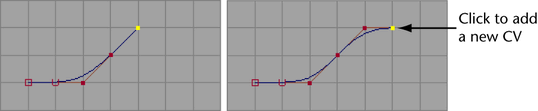

Add CVs or edit points to the end of a curve
- Select the curve to add CVs, or select the last edit point to add edit points.
- Select .
- Click in the view to add new CVs or edit points.
- Press Enter to finish the curve.
