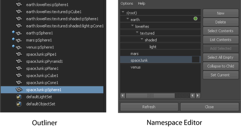

  1. Determine the namespace for a node by selecting any object/node that uses the namespace.
    The namespace for the object/node appears highlighted in the Channel Box and Outliner. For example, an object’s name with an assigned namespace can appear as follows:
    spaceJunk:pSphere1
  2. In the Namespace Editor, select the namespace you want to remove.
  3. Click Delete.

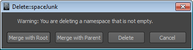

    If the namespace you want to remove contains nodes, the Delete: namespace window appears.
  4. In the Delete: namespace window, click one of the following:
    • Merge with Root to merge the namespace and move the nodes contained by the deleted namespace to the root namespace.
    • Merge with Parent to merge the namespace and move the nodes contained by the deleted namespace to an immediate parent namespace.
    • Delete to delete the namespace and the nodes contained by the namespace.
