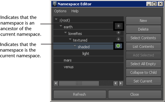

- To open the Namespace Editor, select Windows > General Editors > Namespace Editor
Lets you create, delete, and edit namespaces.
The Namespace Editor displays all the current namespaces, including nested namespaces, in your scene. The root namespace is denoted with ":(root)" .

| Set the current namespace | Select the namespace you want to set as the current namespace, and then click
Set Current. A
icon indicates the currently set namespace.
| Set Relative Namespaces mode so that you can refer to namespaces relative to the current namespace | Select Options > Relative Namespaces. See Set relative namespace mode. |
