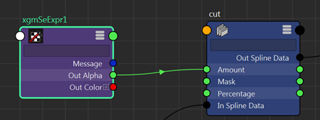

  2. In the Node Editor, create an expression node by pressing Tab then typing xgmSeExpr.
  3. Connect the xgmSeExpr node's Out Alpha port to the attribute you want the expression to control.
    For example, for a Cut modifier connect it to the Amount attribute.

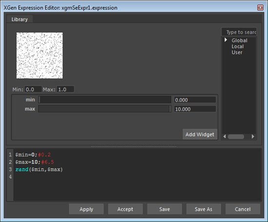

  4. Double click the xgmSeExpr node, and in the node's Attribute Editor, do one of the following:
    • Type your expression beside Expression.
    • Click Open the SeExpr Editor to open the XGen Expression Editor, which you can use to create, load, or editor and expressions.
      See XGen Expression Editor for more information about loading and editing expressions.
