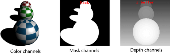

Color channels
Each pixel in a bitmap image contains three color channels, each of which represent the amount of red, green, or blue in the image. Each pixel might also have an alpha (mask) channel to achieve transparency and a depth channel that represents the distance from the camera. Some image formats cannot include embedded mask or depth channels; in these cases, Maya can generate a separate mask or depth file.
Mask channels
A mask channel (or alpha channel) defines where an image is opaque or transparent. Opaque regions of the objects are white, semi-transparent regions are gray, and transparent regions are black.
Use a mask channel to layer images for compositing software. For instance, you can use the mask channel of an image as a matte to composite an object (without its background) with another image.
If you are using Arnold for Maya, see AOVs and Cryptomatte.
Depth channels
A depth channel (or Z depth or Z buffer channel) provides 3D information about an image. It represents the distance of objects from the camera.
Depth channels are used by compositing software. For instance, you can use the depth channel to correctly composite several layers while respecting the proper occlusions.
Maya stores depth values as -1/z. These represent the near and far clipping values.
If you are using Arnold for Maya, see AOVs and Z Depth AOV.
