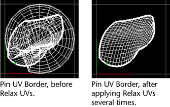

- Pin UV border
Turn this option on to maintain the position of the border UVs. This is the default.

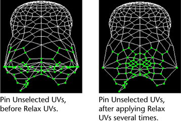

- Pin unselected UVs
Turn this option on to maintain the position of the unselected UVs. This option is useful for relaxing only the selected UVs.
