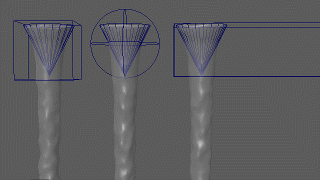

Turn an emitter off or on gradually using its boundary
You can activate and animate an emitter's boundary to turn it off or on gradually. This method can be useful in particular cases, such as when the emitter mesh needs to be rendered or if you do not get the desired results by scaling the emitter mesh.
  1. Select the bifrostEmitterProps node and display its emitterProps tab in the Attribute Editor.
  2. In the Boundary Controls group, turn on Enable.
    The default shape is a box with sides of length 2, displayed as a wireframe in the viewport.
  3. Select a different Boundary Shape if desired, and then scale, rotate, and translate the bifrostEmitterProps node to enclose all or part of the emitter's geometry.
    The fluid gets emitted in the intersection of the boundary and the emitter's geometry.
  4. Animate the bifrostEmitterProps node's transformations to increase or decrease the volume of the intersection.

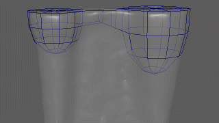

Turn an emitter off or on gradually using thickness
You can animate the thickness used to voxelize an emitter mesh to turn the emission on or off gradually. This method may be slower than other techniques, but it can be useful when the emitter has an irregular shape and other methods do not give the desired result.
  2. In the Conversion group, select a value for Thickness Units:
    • Voxels uses Voxel Scale × Master Voxel Size (set in the main fluid properties).
    • World Space uses the scene grid units, when the Linear working unit is left at the default value of centimeter in the Settings preferences.
  3. Animate the Thickness attribute to control the volume where particles get emitted. Use lower values to shrink the volume and emit fewer particles, and use higher values to expand the volume and emit more particles. To turn the emission off completely, use a negative value with a magnitude that is at least half of the smallest dimension of the emitter's bounding box.
