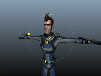

To get a good view of the area illuminated by a spot light
- Select the spot light in the scene, or in the Outliner.
- From the
Panel menus, select
Panels > Look Through Selected.
This represents the view from the spot light, with the green circle representing the light cone boundary. Objects outside the circle are not lit by this spot light.
Camera tracking, tumbling, or dollying work well in this view to help shine the spot light exactly on the desired area.
