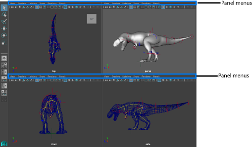

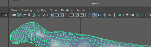

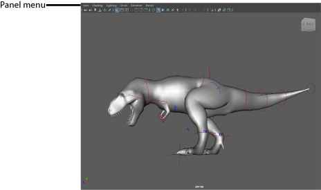

The panel menus appear above the scene view.
When you work with a layout that has more than one view panel, the menus are available for each view pane, and let you adjust options per panel.
