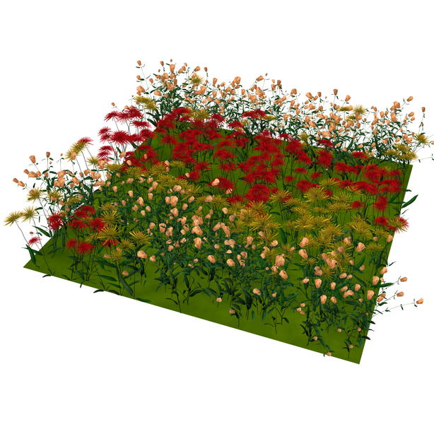

You can use strokes from Paint Effects as instanced objects for particles. The image below was created using Paint Effects strokes instanced to particles.
