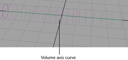

Volume axis curves let you move objects, including particles and nParticles, in various directions along the curve, as well as define a radius around that curve in which the axis field is active. You can select an existing NURBS curve (in addition to the object to which you want to apply the field) when creating a volume curve field. Otherwise, a default curve is created for the volume axis field.

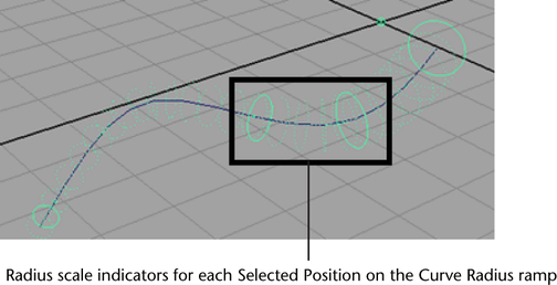

The overall radius of the volume axis field on a curve is set using Section Radius. Using the Curve Radius ramp, you can vary Section Radius along the length of your volume axis curve. When a position marker is added to the Curve Radius ramp, a Radius Scale indicator is placed on the curve in the scene view. These indicators show the points on your NURBS curve where Curve Radius is scaled to specific values.

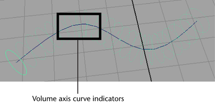

In the scene view, dotted rings appear around the NURBS curve to indicate that the curve is now a volume axis curve.

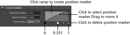

- In the Volume Control Attributes section, under Curve Radius, set the ramp options by doing the following:
- Click the ramp to create a Selected Position for a Section Radius value. The left position on the ramp represents Section Radius at the base of the curve, while the right position on the ramp represents a Section Radius at the tip of the curve.
When a position marker is added to the Curve Radius ramp, a Radius Scale indicator is placed on the curve in the scene view. These indicators show the points on your NURBS curve where Curve Radius is scaled to specific values. For more information, see Volume Axis Options.
- Set an Interpolation method to determine how Section Radius blends between the positions on the ramp. See Volume Axis Options.
