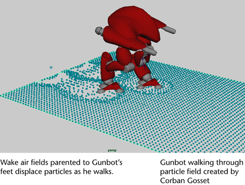

You can parent an air field to a moving part of an object to simulate a wake of air from the moving part. For example, if you have a character walking through leaves or dust on the ground, you can parent an air field to the foot.

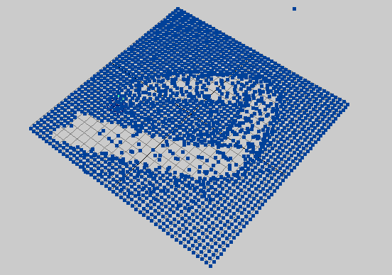

Example: Creating an air wake from a moving object
- Create a grid of particles or nParticles.
- With the particles selected, select >
to display the options window. - Click Wake.
- Click Create. When the air field is created it is connected to the particles.
- Create a sphere.
- Keyframe the sphere to move through the grid of particles (on the XZ plane).
- Select the wake (in Outliner), Shift-select the sphere and then select . This parents the wake to the sphere.
- Play the animation.
