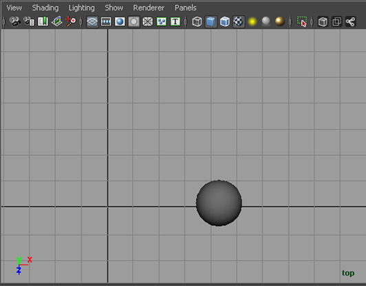

- Create a sphere and position it away from the origin as follows.
