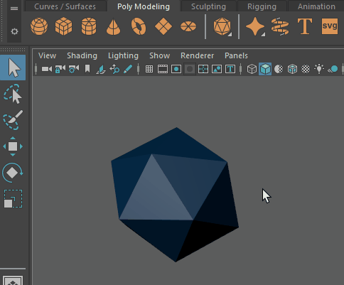

Tweak Mode lets you transform components without the manipulators
Tweak mode lets you transform components (faces, edges, vertices) without having to drag the tool manipulators while in Move , Rotate , or Scale mode. It’s useful for positioning objects in a scene or making quick adjustments to a specific mesh.
Tweak mode is compatible with all component types.
To transform components with Tweak mode
  1. Select a component (face, edge, vertex) on your object.
  2. Choose the transform tool (Move , Rotate , or Scale ) manipulators. You can also use the W, E, and R hotkeys.
  3. Middle-drag the components to transform them. You can also press and hold `(Backtick, found below the Tilde key,) to enter Tweak mode.
    Note: You can also tweak edges and vertices when the cursor is outside of the mesh (in dead space). See Make a selection in dead space.
