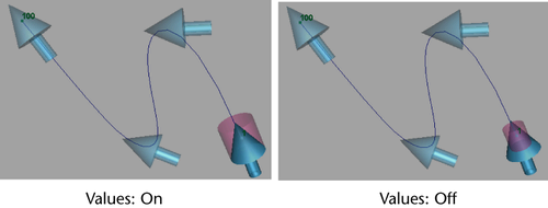

Transfer Attribute values example
The command allows you to transfer more than just basic transform values. You can also use it to transfer any identically named attributes and input / output connections as well.
For example, the Values option in its settings menu allows you to copy all identically named attributes from the source to the target. In the following example, the scale attribute is copied from the arrow to the cylinder when Values is on. When Values is off, the cylinder remains its original size.

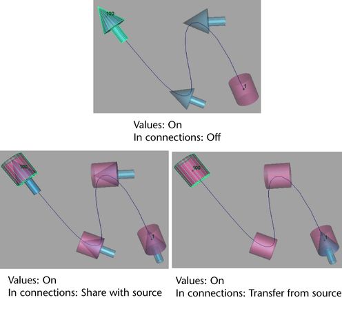

The In connections option allows you to duplicate or transfer all incoming connections from the source node to the target node. This is useful for copying or transferring animation from one object to another respectively. You can see the differences in the following example:
- If In connections is off, the cylinder copies the initial values of the arrow, but does not animate since its movement is dependant on input from the curve.
- If In connections is set to Share with source then both the arrow and cylinder animate since they both have incoming connections from the curve.
- If In connections is set to Transfer from source then only the cylinder animates because the incoming connection is moved from the arrow to the cylinder.
