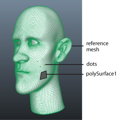

- In your scene, move the cursor over dots while holding Shift.
The Quad Draw tool enters face preview mode, highlighting the possible faces in green.
It is helpful to preview faces because one set of dots can have many face combinations.
- Shift-click a face preview.
A new surface called polySurface1 is created.
Tip: Select to superimpose a wireframe on the reference mesh. - Continue to add faces by dropping additional dots and extending existing edges. See Extend edges with Quad Draw.
