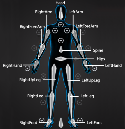

If mapping an existing skeleton, you must map all fifteen nodes required by HumanIK. This identifies the main elements of your character's skeleton. You cannot use HumanIK to control your character at runtime if you do not provide a characterization for these fifteen required nodes. In the HumanIK window, you cannot save or lock a characterization until you have successfully mapped all of these required nodes.

The fifteen nodes required by the HumanIK solver display in the full-body layout of the Character view, and grouped together in the Required group of the Name Match view.
These required nodes identify the main joints in your character’s skeleton: its ankles, knees, hips, spine base, shoulders, elbows, wrists and head. Figuring out which bone in your skeleton map to each of these nodes is generally straightforward:
Node Maps to
Hips The bone that is the parent of your character’s spine and leg chains.
LeftUpLeg and RightUpLeg The first bones in your character’s upper legs.
LeftLeg and RightLeg The first bones in your character’s lower legs.
LeftFoot and RightFoot The first bones that extend from your character’s ankles into its feet.
Spine The first bone in the spine that is above the bone you map to the hips node. Represents the base of the spine.
LeftArm and RightArm The first bones in your character’s upper arms.
LeftForeArm and RightForeArm The first bones in your character’s forearms.
LeftHand and RightHand The first bones that extend from your character’s wrists into its hands.
Head The last full bone in your character’s spine, not the tip of the head, but the last full bone in the neck chain. This is typically the bone that controls the skinning of the head.
