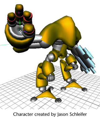

Character sets let you group attributes from multiple objects into a single node that you can then select and key. Character sets are useful when you want to animate multiple attributes from many different objects all at the same time. For example, you can use a character set to bring together in one node all the joint rotations of a character’s legs. The character set could be anything: a well-armed robot, an automobile, or even some seemingly unrelated collection of objects.
