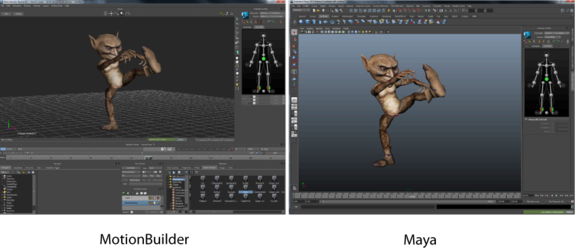

Send Control rigs to MotionBuilder
  • File > Send to MotionBuilder
  • Note: The File> Send to... options only appear in the Maya File menu if you have the equivalent version of the destination application installed. For example Maya 2022 only has a send to option for MotionBuilder if you have MotionBuilder 2022 installed as well.
Use Send to commands to transfer HumanIK character data between Maya and MotionBuilder which means you don't need to export your characters from Maya to FBX to import them into MotionBuilder.
Note: You can also use Send to commands to send standard objects and animations, as well as HumanIK characters, to MotionBuilder.
