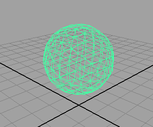

To model the balloon you will create a Icosahedron. This will result in more realistic movement than a polygon sphere.
- In the Polygons menu set select Create > Polygon Primitives > Platonic Solids >
. The Polygon Platonic Solid Options window appears.
- Set Platonic Type to Icosahedron and click Create.
- Select Mesh > Smooth.
- In the Attribute Editor, select the polySmoothface1 tab.
- Set Method to Linear
- In the Linear Poly Smooth History section adjust the attributes as follows:
- Division Levels: 1
- Divisions per Face: 3
- Push Strength: 0.8
- Roundness: 2
Resize and reshape the balloon

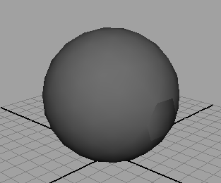

In this example the balloon model for the balloon will remain spherical. You can optionally reshape the model into a more balloon-like shape.
- Select the balloon and select the Move Tool.
- Move the balloon above the ground plane (in the positive Y direction).
- Select Smooth Shade All mode (hotkey: 5).

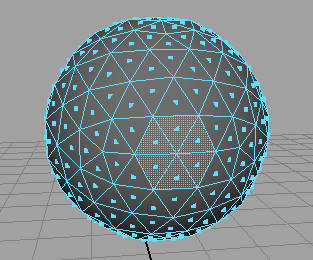

-click the balloon and select Face from the marking menu that appears. The balloon now appears in face selection mode.
- On one side of the balloon, select 6 adjacent faces that form a hexagon.
- Press
. The selected faces are deleted.

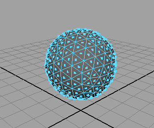

- In the FX menu set select the balloon and then select nCloth > Create nCloth.
Maya converts the polygon balloon into an nCloth object.

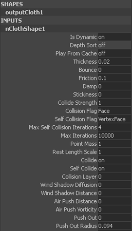

To adjust the balloon's attributes
- Select the balloon.
- In the Attribute Editor, select the nClothShape1 tab.
- In the Collisions section set Thickness to 0.02.
- In the Dynamic Properties section set Stretch Resistance to 80.
- In the Pressure section set Pressure to 0 and Seal Holes to On.
- In the Quality Settings section set Evaluation Order to Parallel.

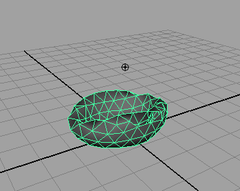

- Playback the simulation.
The deflated balloon falls to the floor.

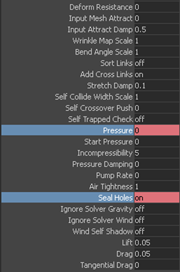

- Open the Channel Box and under Inputs, select nClothShape1.
- Select Pressure and then
-click Seal Holes to include it in the selection.
-click either name and select Key Selected from the context-sensitive menu that appears. The fields will change color to confirm you set the keys correctly.
