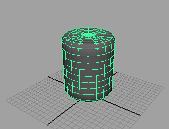

Create an nCloth can
This is the base model for the can and the input mesh for your rigid nCloth.
To make the soda can model nCloth.
- In the FX menu set select the can and select nCloth > Create nCloth.
- In the Attribute Editor, select the nucleus1 tab.
- In the Ground Plane section turn on Use Plane.

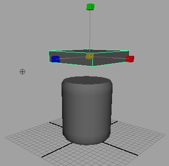

- Select Create > Polygon Primitives > Cube.
A polygon cube appears at the origin. The cube is obscured by the can when it is initially created.
- Select the Move Tool from the Tool Box and move the cube up so that it rests above the can.
- Select the Scale Tool and scale the cube so that its length and width are the same as those of the can.
- Select nCloth > Create Passive Collider.
